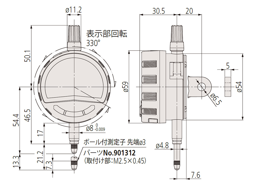

/pim-assets/medias_converted/Highres/Mitutoyo/Media/ExternalDimensions/04_Indicators/04_2_543-700他_202301_d_1_jp.jpg
