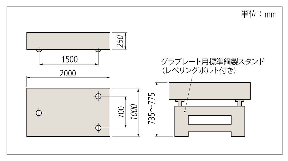

/pim-assets/medias_converted/Highres/Mitutoyo/Media/ExternalDimensions/06_ST other/63_1_517-410-4_202311_d_1_jp.jpg
