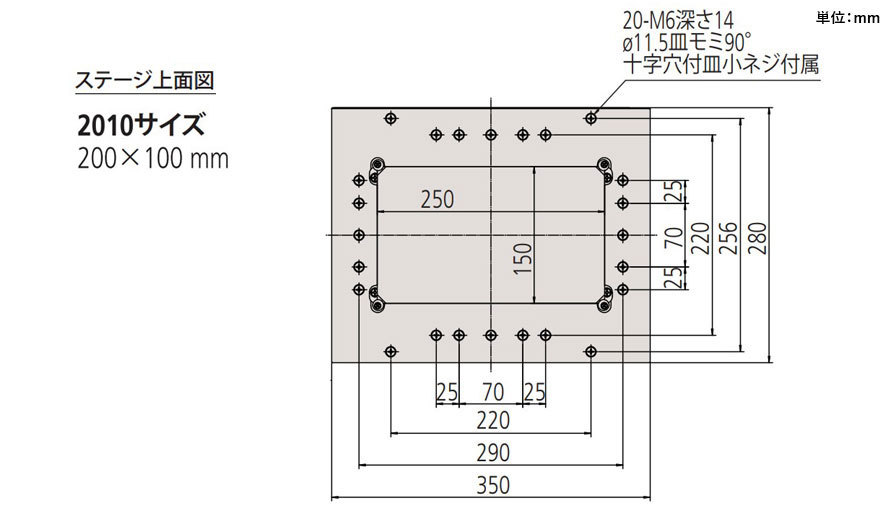

/pim-assets/medias_converted/Highres/Mitutoyo/Media/ExternalDimensions/13_Optical Measuring/32_1_176-962-10_202404_d_1.jpg /pim-assets/medias_converted/Highres/Mitutoyo/Media/ExternalDimensions/13_Optical Measuring/32_1_176-962-10_202404_d_2.jpg /pim-assets/medias_converted/Highres/Mitutoyo/Media/ExternalDimensions/13_Optical Measuring/32_1_176-961-10_202404_d_3.jpg
