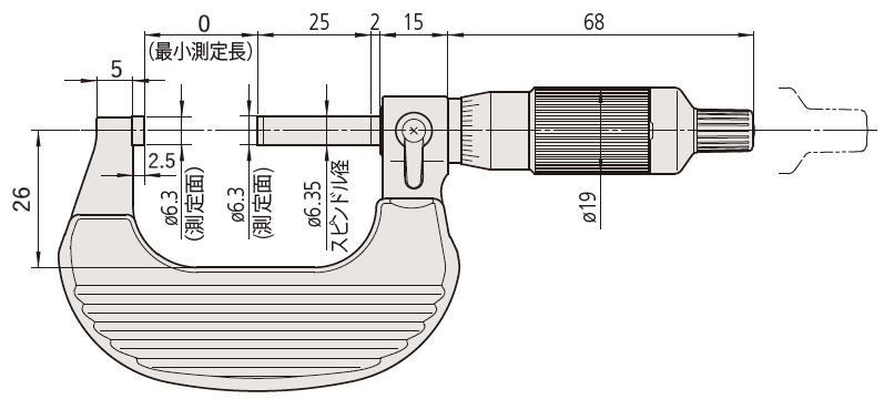

標準付属品
![/pim-assets/medias_converted/Highres/Mitutoyo/Media/ExternalDimensions/01_Micrometers/01_0_102-701_202311_d_1_jp.jpg](/pim-assets/medias_converted/Highres/Mitutoyo/Media/ExternalDimensions/01_Micrometers/01_0_102-701_202311_d_1_jp.jpg)
