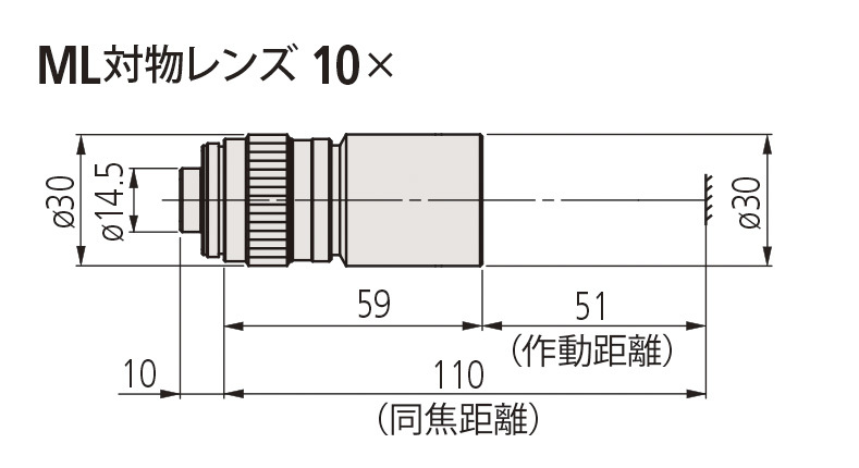

同焦距離(mm)
110
110
110
110
110
110
110

作動距離 WD(mm)
61.0
61.0
77.0
51.0
20.0
13.0
6.0

/pim-assets/medias_converted/Highres/Mitutoyo/Media/ExternalDimensions/13_Optical Measuring/32_2_375-039_000000_d_1.jpg
