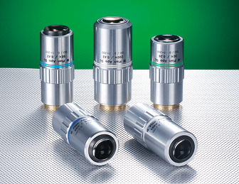

接眼レンズ WF20×/12
- 378-858
M Plan Apo 7.5×
- 378-807-3
M Plan Apo 10×
- 378-803-3
M Plan Apo 20×
- 378-804-3
M Plan Apo 50×
- 378-805-3
M Plan Apo HR 50×
- 378-814-4
M Plan Apo 100×
- 378-806-3
M Plan Apo SL 20×
- 378-810-3
M Plan Apo SL 100×
- 378-813-3
G Plan Apo 20× (t3.5)
- 378-847
