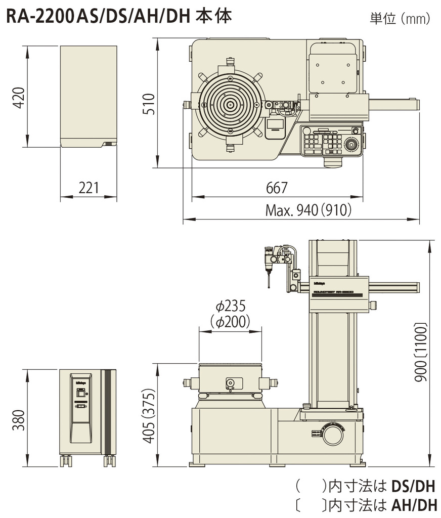

/pim-assets/medias_converted/Highres/Mitutoyo/Media/ExternalDimensions/15_Form Measurement/41_2_RA-2200AS-DS-AH-DH_000000_d_1.jpg
